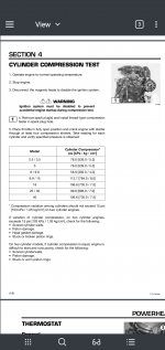

Because of that i want to make sure she is in good health before i take it out...so i did a compression test with both plugs out throttle wide open... Spec is 110psi
top cylinder is 95psi
bottom cylinder is 185psi
I pulled exhaust cover off to see if there was a blockage of some type and while i didnt see any blockages is did find the tip off a fin of the water impeller and it does look like new rubber (water still pisses but going to change reguardless)
so why is the lower cyliner compression 163% than manf spec?
im about to order head gasket so i can pull that off and take a look see... anything else i need to order or look at?

the motor was not warmed up at all... ran test 4 times on both cylinders... 3rd and 4th time i added a lil bit of oil and pressure was 3or4psi higher on top cylinder than previous 2 test.
bottom cylinder had same psi all 4 times... of 180psi... i even wrote down the psi on the head and immediately texted a buddy who is good with engines so i am 100% certain that was the reading that the brand new compression tester displayed.
i did give the incorrect spec in post...
The CORRECT spec is 99.6 psi.
( I JUST NOTICED it does say to, bring up to normal operating temp at the top when double checking speck)
I will run again tomorrow but this time i will record test before and after running at idle for
3 min and post the results.

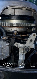

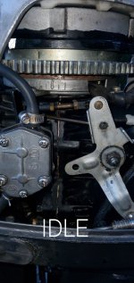

SEA RIDER.... i saw that your the go to guy in another thread about 25 to 30hp conversions... cjances are the previous owner already did it and from i see its carb gasket and timing... the current carb gasket inside diameter is the same size as opening... so how can i confirm timing has already been adjusted? if there's already a thread where you explained it and dont mind pointing me in the direction i would greatly appreciate it. THANKS

What you can do is : with left hand any finger rise the white roller fully up till stops, with right hand throttle the grip fully till the cam stops against the roller, slowly throttle the grip back and forth just a bit, if the synch is right should hear a light banging going on between the cam and roller which is spot on. Which boat/size is being powered with said motor and how loaded do you generally go boating with ?
Right now the timing seen on second pic shows stopping at 20 deg which corresponds to the 25 timing, the 30 HP timing is 25 deg. As you have witnessed it's not all about a carb gasket swap, that's just half of the equation...

Forgot to ask you on my last posts when the center console's throttle is set to max forward, while previously geared forward, check if the white roller stops at the cam's middle indent/groove, if so, that's the 25 HP carb setting with the time plate's mark stopping at 20 deg.
Or at the upper cam's hill as seen which corresponds to the 30 HP carb setting with timing plate's mark stopping at 25 deg.

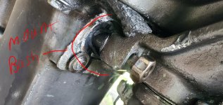

SEARIDER... i haven't had the chance to look into the stuff in your response... at the moment im trying to get the upper motor mount to come loose...hindsight it probably didnt need changing, but the exposed portion was dry rotten and from trying to heat the thru hole for the mount i ended up burning it (I KNOW I KNOW) on the opposite side it has come loose from the drive housing side... on the passenger side its stuck like ****.... i have heated housing slightly, sprayed freeze off... kroil oil... and countless other penerateing oils and notta... i put double nutted bolt and got it to spin... any other tricks on getting this guy loose? i was using a brass hammer at first until i noticed it was marring surface, had to use file to remove material from in front of bushing.... im about to try an air hammer with blunt tip caise i do not want to cut it... any tips would be greatly appreciated...

between everying i had previously done and the air hammer on the face of the bolt with 2 nuts to protect threads it came loose... will probably need to use slide hammer or spacer pipe and use bolt threads to pull from housing... thanks though... will look at timing when i get it back together...

Don't worry Sparkey take your time, that horse needs to be fully operational before working on the carb/timing advance synch. That's the bolt that crosses side of the steering shaft and secures the middle leg in place, right ? Sorry can't help you on this one, never have issues with seized bolts, always grease them well with marine grease from time to time since out of the box specially boating on salted waters.
