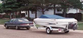

One day I pulled the boat into the ramp and got in the car. A bunch of millennials came over and said they were waiting to see what that old car could possibly pull. One minute of winching and the rig was in the lot. They shut up quick.

That looks like a Pontiac. I doubt it's Tow Rating is for more than 1000lbs.
My Buick and Cadillac came from the Factory with the Towing Option, with Heavy Duty Suspension, Heavy Duty Brakes, Larger Capacity Cooling System with Mechanical and Electric Fans, Two Transmission Coolers, Modified Transmission and Shift Programing, and Larger Rear Axle Assembly. The Cadillac even came with a 5 Connector Wiring Harness already wired, and stored in a pouch between the Rear Fender and Trunk Liner. Both Cars have the Second Gen LT1, and are capable of towing at speeds well above 75mph.
A lot of clowns don't realize that a few decades back, most tow vehicles were cars. And the Trucks of the Day were a more realistic size than the Hideous things sold today. I have launched and retrieved my boat from gravel and dirt ramps that had 4x4s digging themselves stuck.
It's a 1980 Bonneville. It is equipped with the factory towing package with most of the things you itemized. Factory specs list a 4500# towing capacity with the package.
I wasn't aware of Pontiac offing a Tow Package Option, of course I will admit to not knowing much about any Pontiac. I know a lot about Olds, Buick, and Cadillac, mainly because those are the Brands I have owned, 2 Olds, 3 Buicks, and 5 Cadillacs. Current ownership, licensed, insured and on the road, are 1 Buick, and 2 Cadillacs
