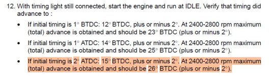

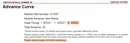

I checked my timing today (2015 Merc 3.0) following the service manual procedure (jumper on distributor, cutout switch bypassed). I observed the following:
Base initial timing w/ jumper was spot on at 2* atdc; idle timing w/o jumper was also spot on at 15*, however timing at 3000 rpm was only 22* rather than the 26* the manual calls for. I suspect an internal component in the distributor is failing. Thoughts as to what I should look for?

Doubt that Engine has a Mechanical Timing Advance, but rather an Electronic Advance.

Verify the tach is correct in case it is reading higher, or did u reving above 3 k and see advance stopping? Usually this relates to the ignition module failing. The module is inside the distributor

The ignition module is available separately. I think if you google delco est module you will find the cross over to the GM module. you are correct to do some basic items if maintenance was neglected. I would hold off on that for now…

If those 2 are good set advance at 2* BTDC and see if performance increases. If it does increase check advance to see if it's closer to 26*. If it has look at new module

I meant to say the base timing was set at 2* AFTER TDC per the manual for this serial number engine, not before. So then adjusting distributor to 0* advanced all readings by 2*. Again, still a bit low.

As mentioned I would set the dist so you get the full 26 degrees advance and see if it helps before getting the parts cannon out...
