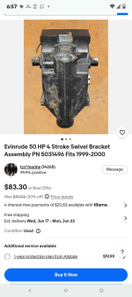

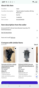

Ok think I found one on the bay, number matches. Do I have to remove power head to replace this?
Mc Tool
Aug 7, 2024
2,026
No , I dont think so but,............honestly I dont know for sure not being familiar with your model , I have done such disassembly on other outboards but there are others here that will know way more than me as to the actual procedure for your motor . Im pretty sure you will need some way of lifting and supporting the weight while you do the job tho 🙂
