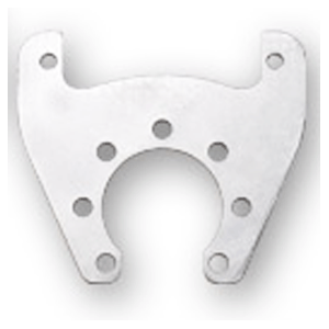

2021 I had a shop install actuator, calipers etc on my trailer to get through inspection. 2024 I am doing maintenance on the trailer brakes as the starboard side caliper locked up on me. What I found during my break down of the brakes was a bit disturbing that the mechanic now fired from the shop would go ahead and install this slider pin. The slider pin looked as if it had a large piece of solder halfway down the 7/16-20 thread. I did not get a picture of it before I ran a die down on it but it still useless after.
I purchase another slider pin from eastern ($7.00 and $9.00 shipping wtf to that) and when I try to install the caliper slider pin on the bottom to the bracket, it grips in but it never tightens down. So I can not torque it down. I am not sure if I can run a tap through it to fix the threads or if I should purchase another bracket. Most places sell the bracket with a caliper.

Sounds like the plate is stripped.

Yes the plate is striped. I removed it yesterday and tried to tap it with 7/16-20 but it just wiggles as the slider pin screws in.

Take the plate to a welding shop and they can weld up the hole, then re-tap
I thought about this until I found a reasonable price for the item with shipping. At first I thought it was one of those parts that you have to buy a caliper with it to get the bracket.

HeliCoils. Usually stronger than the original threads.
$10 in parts and a 1/2 hour of your time.

Giving the thickness of the plate and the fact that it has lost some of the metal you think this will still work? Most I see using these could go up a bolt size but I have a slider pin that must fit the caliper and the thread.
Yup
