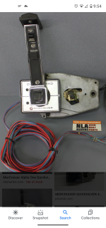

There is a finger trigger with a thumb switch for "Trailer" option. Identical to the screenshot. The reason I'd like to replace it is because that trigger neutral lock broke and I just assume replace it completely.

Newer motors do not use the trailer function. Trailer was used on the older 70s-80s two outside trim cylinder Mercs, and Mercruiser sterndrives, to assure that you did not over trim them.
Newer OBs have 1 or 3 trim cylinder PTT units. They only trim up so far when under under power of boat while cruising, and tilt all the way, when engine is in neutral or off. So you only need the toggle switch under your thumb.
