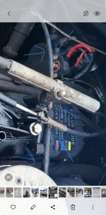

On my 1997 190 stingray need this throttle cable. Am I able to just replace the end or do I need the whole cable.

Ayuh,.... Welcome Aboard,.... The replaceable ends are secured with a couple of tiny square headed screws,.....
Can't tell in yer picture though,....

The line with blue arrows (throttle ) do I need to replace whole line or can I just get the end fitting

Usually control cables have crimped/non-removable ends. New cable is needed and the lengh is printed on the cable sheath1657109395631.png1657109320028.png
