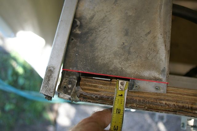

update here's images of my transom you guys where right when I removed the rear rubraill the plywood was rotton also image of the bass boat hydrolic steering sys.
hopefully I can easly transplant into the chiefs helm station.
thanks Guys for the surport.
TB

upper inside transom
I'm assuming this is where to cut? and bend
TB

Before you go to cutting the transom, pull the cleats and try to gently bend it up after the rub rails are loosened enough for it to clear. Your transom top is different than mine but I think I seen someone here do it that way. I've read so many threads I don't know which one it was though.

I wouldn't cut the top deck. I'd make every attempt to remove it, then cut only the ends of the gunnels as they sit on top of the transom plywood. Details in post #25 above. - Grandad
