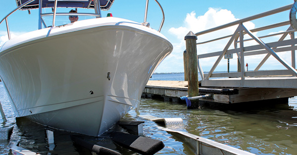

dingbat
Nov 20, 2001
17,322
I launch and load by myself, with self centering rollers and side guides,
Switching to a drive on trailer with target bunks was a no brainer once I saw one in action.
The poles are mainly used to line up the boat with the trailer. The poles only contact the hull on the rub rails. Don’t have to worry about debris (sand) getting stuck in rub board (side guides), scratching up the gelcoat. The bunks that do all the heavy lifting.

dingbat
Nov 20, 2001
17,322
No need to buy a " drive on" trailer, most any trailer can be turned into a drive on trailer with a few addons and adjustments.
Sure, you could rig something up I guess, but the torsion V axle conversion (lowers trailer to ground) alone would cost me $2,000 plus labor alone.
To that you have to add the cost of the target bunks, misc brackets and hardware, adjustable guide poles, etc. Could easily see the conversion of an existing trailer costing all most as much, with labor, as new

dingbat
Nov 20, 2001
17,322
Why change out the axle ?
Tide….
Running a continuous variable hull. Bow drafts 14” more than the stern. Basically a big wedge.
The torsion axle combined with the extra clearance carries the boat 10-12” lower than its predecessor. Can float the #5k hull to the bow stop in knee deep water.
