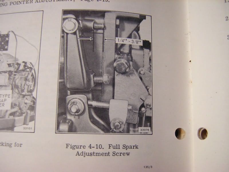

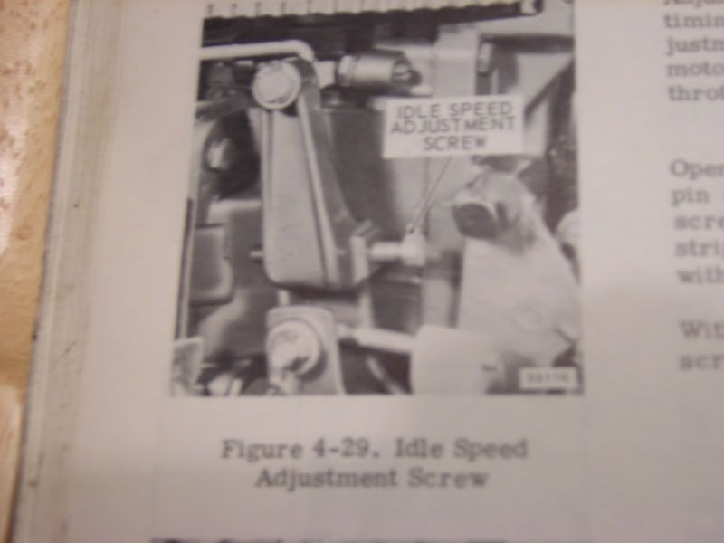

hey tesla ive got the same motor as you and own the factory manual.if you want i can give you the proceedure or you should def. get that manual above.by the way its not that long at least ours isnt!two maybe three paragraphs.itll be tomorrow evening at the earliest though. let me know or catch that manual while you can there a rare find.
tschamp20
May 10, 2006
317
Re: Synchronizing linkages
so i kinda lied its more than 3 paragraphs. here it is.
tschamp20
May 10, 2006
317
a little out of order,sorry hope this helps.if theres anything else let me know
