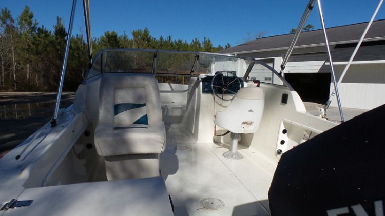

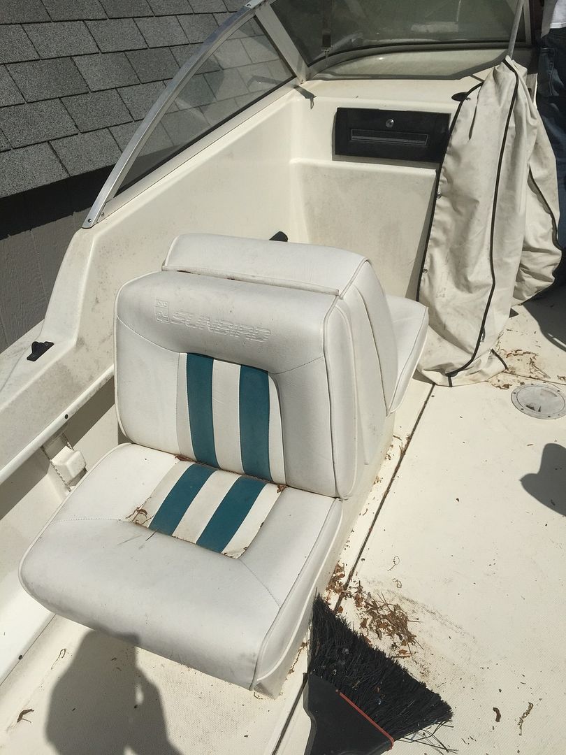

Hey guys just wondering if it is possible to take out the huge back to back lounger seat on the passenger side out and put a captains chair in there instead. How are these seats typically fastened? Floor is solid, but will Stainless steel wood screws hold the base of the captains chair down solid enough to be safe and not tear a hole in the floor? I doubt I will have room to get under there and nut and bolt the seat down.

You should be able to look under the existing seats to see how they fasten. My back to back just has stainless wood screws. Make sure you check the length of the existing screws. The Captains chair should fasten the same way.

I can't tell in the pics if you have a molded (part of the deck) or a sit on top box. If the box sits on the deck, there are usually a pair of cleats running from side to side with wood screws holding the box down. Molded box is a lot of work to eliminate. Not impossible, but work.
Adding a pedestal needs good solid fastening or the Admiral will be laying on her back throwing stuff at YOU. Wood screws usually don't work.

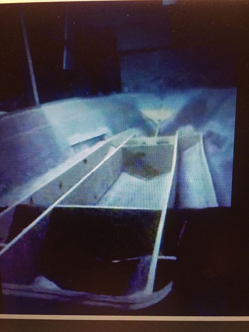

You can see where the stringers are on this boat. Basically right under where the captains pedestal is located. I doubt there would be room underneath to do anything since the deck is setting right on the stringers. I am surely not trying to put more effort than this is worth into it. I just like the idea of the extra room when I go fishing.

The problem is the deck. There just isnt any way to spread the load of something with such a high leverage point without being through bolted and fender washers ( better yet a plate ).
Thats why the above picture was glassed up..the deck isnt the deck there any more..its more load bearing/dispersing now. I guess you could come up with a plate that is screwed and glued down with a larger footprint. I dunno..some half inch alum can be painted and tapped with 1/4" threads..then bolt your base to that. Theoretically that should work. Check your deck status before you put too much time into it though. Water might have gotten into it from the cleats that the back to back is mounted to.

In your first set of pics of the lounge seat, it looks like the seat base has some nice rounded corners. What you could do is shorten the box to make it square, keeping the rounded corners. Make a lid and mount it on the box with a hinge(s) and a latch. Use one of these
with a helm seat that matches or near matches the current helm seat. In the end you have a pair of helm seats, one on a pedestal and one on a storage box with a footprint about the same size as the seat.
Also in the first post, it looks like you have a fuel tank access panel. Can you remove it and get to the underside of the deck to add a doubler plate for pedestal mounting?. The tank space is probably a sealed well, but maybe not.
