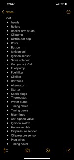

Hey this is my first time on here but I have a 2001 bayliner with a 5.0 mercruiser. It will randomly lose rpm and jump right back up. The boat will pull back a little then speed back up. I’ve been chasing this problem over 2 years. Sent it to many mechanics and tore it down twice. I will attach a video of the problem and a list of all things I have changed. Almost a completely new motor at this point. It won’t let me post the video but the best way I can explain is I’ll be cruising and everything’s fine. Rpm’s will randomly drop and shoot back up by itself and the boat will slug back a little then go back to the same speed

I’m sorry I’m new to this. It is carbed. It’s my first boat so I’m not super familiar with it. Im learning as I go. I can get a vin number. But I just bought new NGK BPR6EFS spark plugs. It did have ac delco I think gapped at .40. And the picture is what I mean by a computer.
