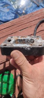

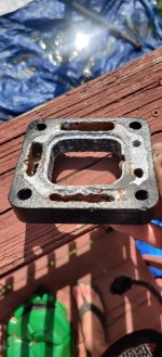

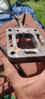

Getting close. Put the motor in without the spacer. The alignment is the same as it's always been (not perfect, but I think acceptable). Was able to fire it up on muffs.
1. That O2 spacer was toast. I'd love to have it in there, but that was leaking. Plugs had (I think) some salt deposits on them. I'm going to email Hardin and see what they think.
