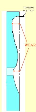

What did you use to Home the Cylinders? Please don't tell me a Ball Hone...
2 Stroke Cylinder Walls wear differently than the Walls in a 4 Stroke. A regular Honing Stone will quickly reveal the Wear Areas around the Ports, while a Ball Home just camouflages that wear, besides messing up the Ports
