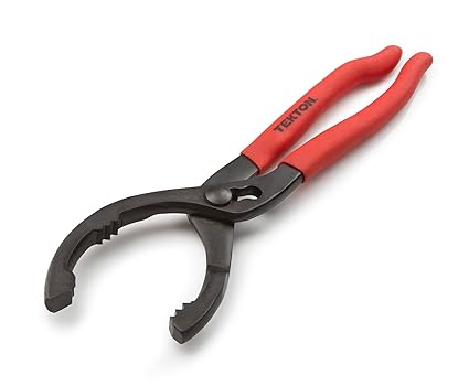

I think I'm going to try the pliers next. Fingers crossed I dont have to stab the current filter.

The pliers that Grub posted WILL remove it, but it is going to be messy. I've had to use those exact same ones on a previous boat. A gorilla apparently installed it, and there was no way it was coming out without at least some holes in it.
Sometimes it does get messy. I usually get a good grip with them and give it steady constant pressure, if you jerk it, the filter will get ripped. They always get bent, but who cares, it's junk anyway.

[IMG2=JSON]{"alt":"Image result for Oil filter pliers","data-align":"none","data-size":"full","height":"350","width":"425","src":"https:\/\/images-na.ssl-images-amazon.com\/images\/I\/71ftmkQ-PLL._SX425_.jpg"**[/IMG2]
This is what you want !
