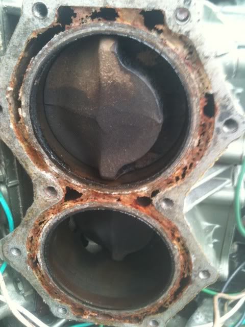

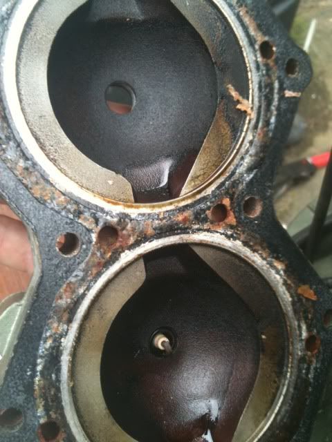

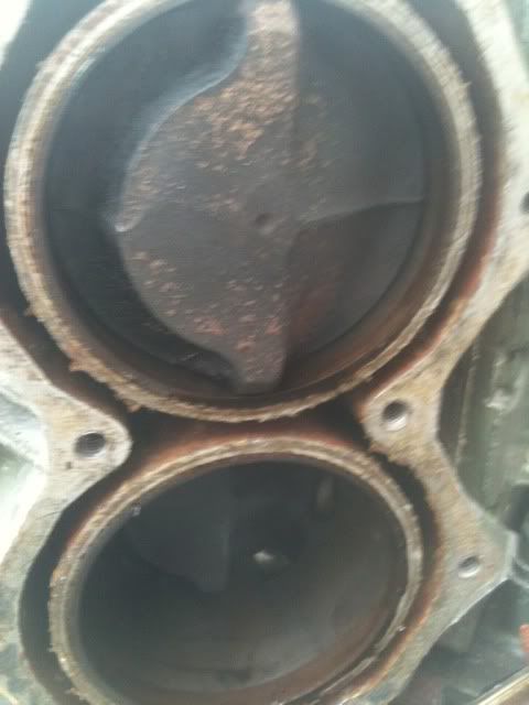

Ordered new gaskets today. I was pleasantly surprised that the head bolts came out with unbelievable ease! They weren't loose, but I was surprised that it took very little effort break 'em free. 1/2 turn with the wrench and took them out with my fingers the rest of the way. Both heads were easy. I'm guessing that the PO's mechanic had the heads off at some point cause the gaskets were in great shape.
The starboard side had a "film" on the water jacket opening(see pic), but it fell right off with ease. Both cylinders are smooth as a babies butt, No scoring at all. :D Ports are clean(just a small spot or two of carbon).
starboard side
Port side
