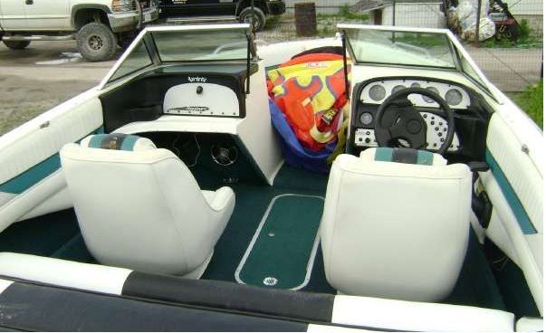

Re: stringer repair
yes that is the same boat you can barley make out that the floor in the bow is about 1/2" higher that the rest of the deck that 1/2" floor is what i need to cut out

Re: stringer repair
it keeps flipping that picture upside down on me. this is a terrible picture and i apologize for that in advance .
You can kinda see whats going on in the picture. If you look Where the stringer is sitting, just inside of it you can see the discoloration where the ski locker was. There is two 4' stringers that make up the sides of the locker they also support the deck under the bow. To get new wood under there i need complete access to about 1/3 to 1/2 of the bow floor I figure i can cut the floor build the ski locker lay the new floor carpet the new floor then graft the section of bow back in and carpet over the ugly graft repair

Re: stringer repair
Yea w/o seeing what you see, it's will be hard to agree or offer an opinion.

Re: stringer repair
A few pictures from different angles would be good. Your idea may be OK, but it is hard to tell from the 1 picture.
