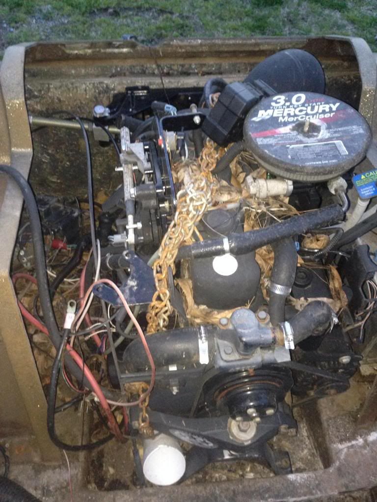

wow I have to agree with woodonglass its all got to go. from the picture ill bet when you get it tore out you will find that is all water logged. I just tore out all the stringers out of a 72 tri-hull. its not that bad. the hull is thicker than you think. good luck.

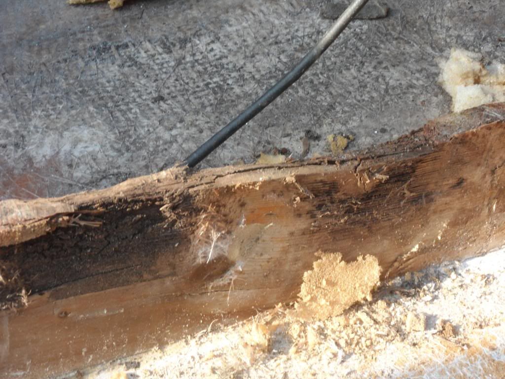

yea got one lose yesterday after talking to you guys and friscoboater on fb i went out there and got to work before it got dark i got to make a trip to harbor freight for some blades

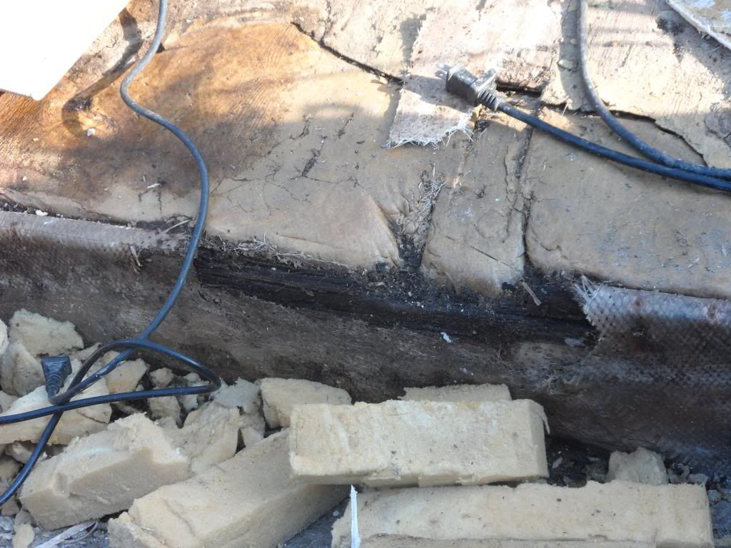

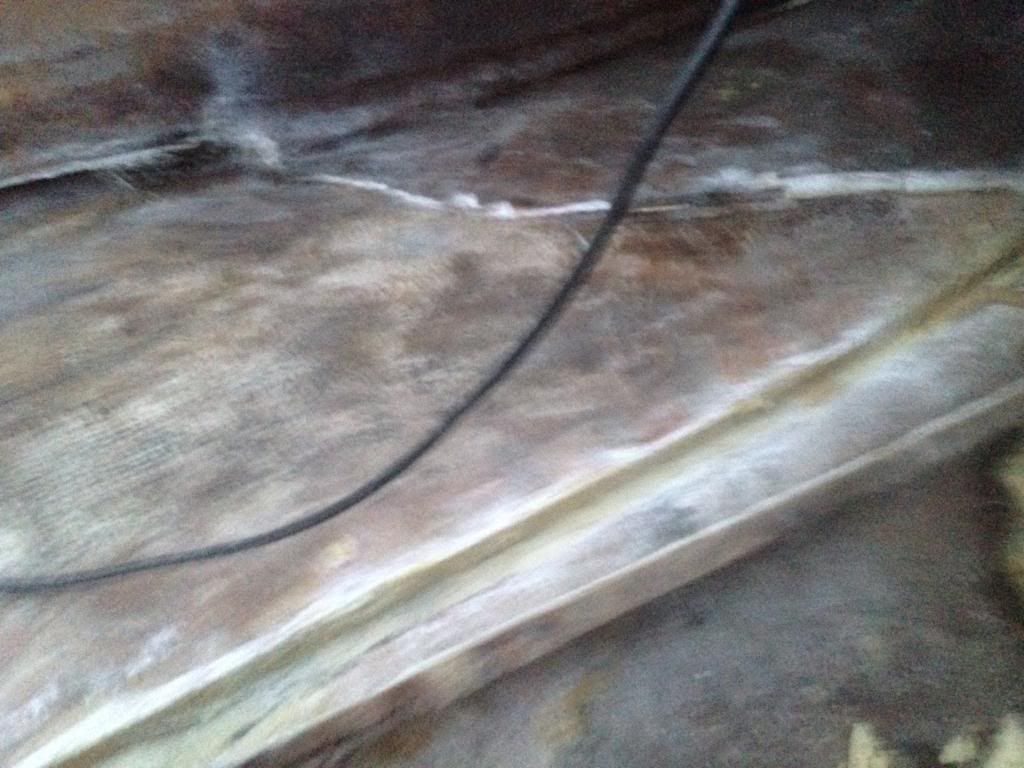

this is what i was tring to show yall that i did in fact get the stringer lose even though the 2nd pic is blury

Ok, gotcha. What did you use to cut out the stringer?
