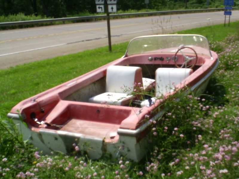

I wasn't thinking earlier. I have a fine example for you. This boat had been in the water sometime last year according to the previous owner. This boat shouldn't have been in the water at all for probably years...
Notice in the following picture the large aluminum plate that was attached to the back of the boat to "reinforce" the transom...
This is what it was "reinforcing."...
A pile of wet woodchips. Not pretty or anywhere's near safe. The physics involved with the transom and hull don't allow for reinforcement, only replacement. If the transom's rotted, it needs to be replaced. You can also bet from the age of the boat that if water's been getting in on a regular basis and the transom's rotted, the stringers and and decking underneath are too. You can also bet that the floatation foam that was used is soaked and needs replacement as well.
Gun that 85 horse and you may find it up in the bow, with where it used to be slowly sinking as you scramble for your life-vests.
