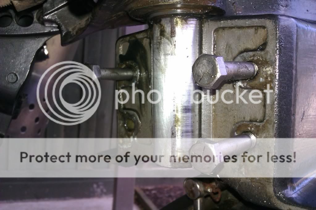

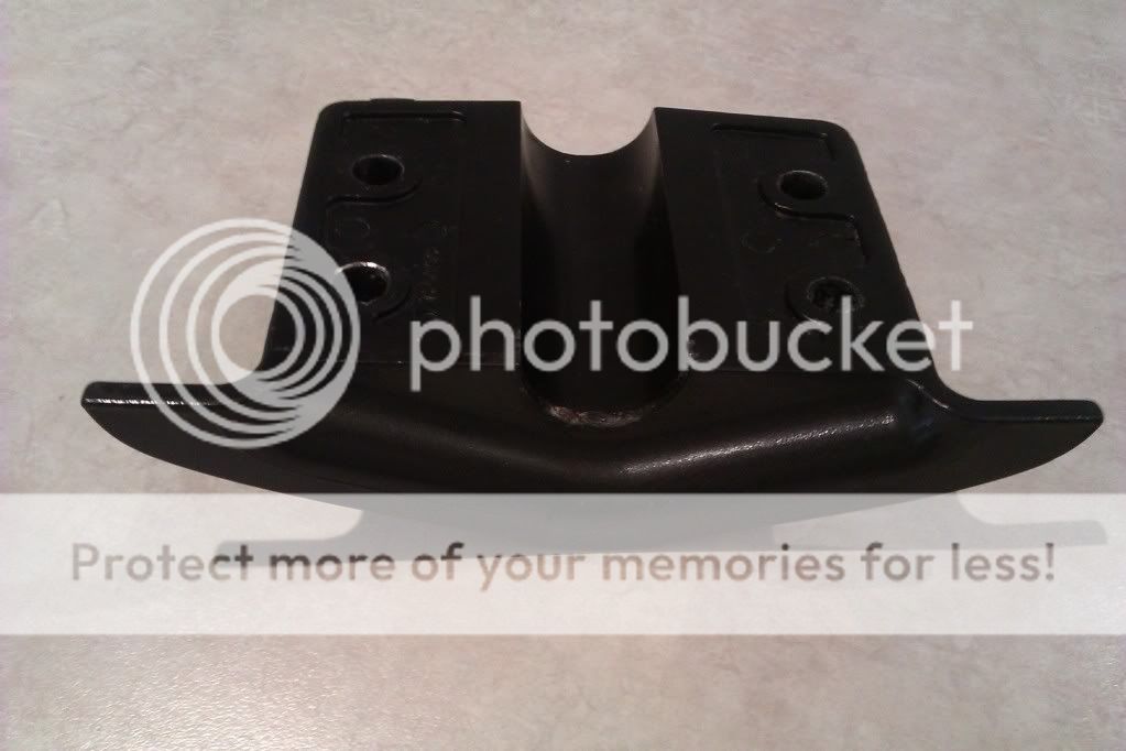

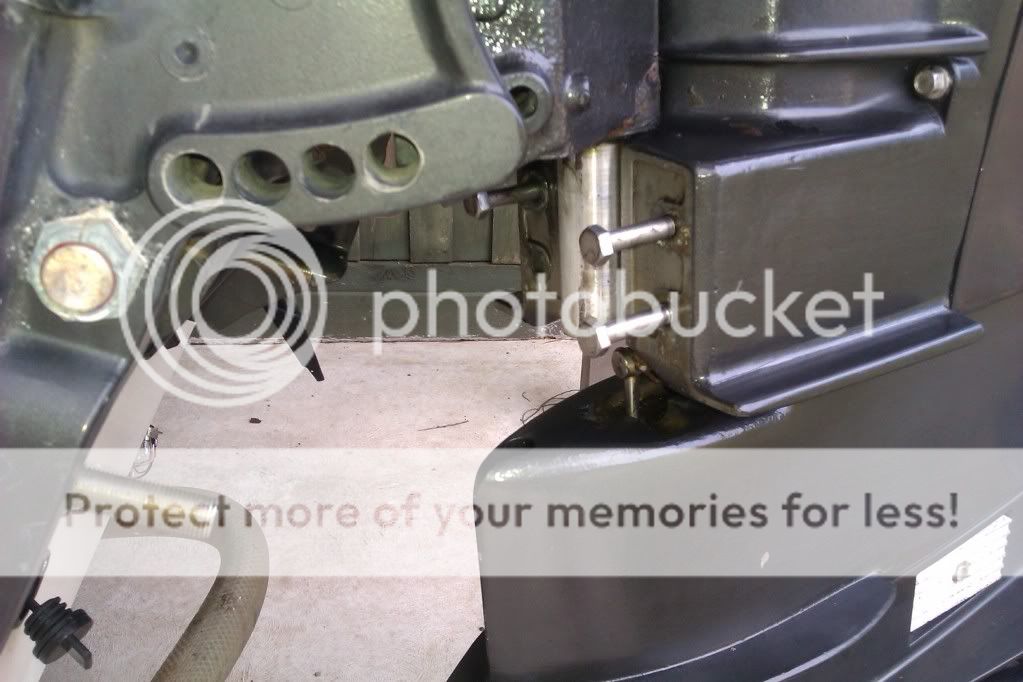

Thanks for your reply. I have attached some photo's
It is I think a 1990 model, today I removed the plate behind the bottom shaft and as soon as I released the preasure of the 4 bolts the motor turned very easily, so I cleaned the shaft, pumped new grease through until all the old grease was removed, cleaned and greased the plate that is half cuped to fit around the shaft and put it back on, but as soon as I re-tighten the 4 bolts the motor cannot turn again, it seems like the plate does not have enough clearance for the shaft to turn???? as soon as I loosen of the bolts a little the motor turns?? Buggered If I know how it ever could work freely??

Lookls like the shft has been scored.
Try sanding the inside of the cover a bit.
Find the tourqe values for the cover.You might be over tightening?
Your motor looks to be newer than a 90
foodfisher
Feb 18, 2009
3,756
Re: steering tight from pivot points on motor
My CRS brain seems to remember a plastic sleeve that has to be delt with. Reamed and sanded. Oh yea!The pivoting occurs up higher. That part pictured is supposed to hold firmly.
