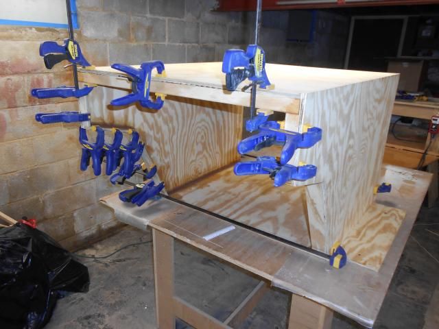

Not sure if anyone wants to see the build, but it may be interesting to see a first timer try to work with fiberglass. Might be good for a laugh, or a learning experience. I am using plywood carcass covered in poly and 2 layers of 3/4 oz csm from us composites. Here are some pics of what I have started so far.
this is a rough mock up of what I'm aiming at for the console.

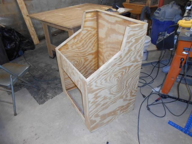

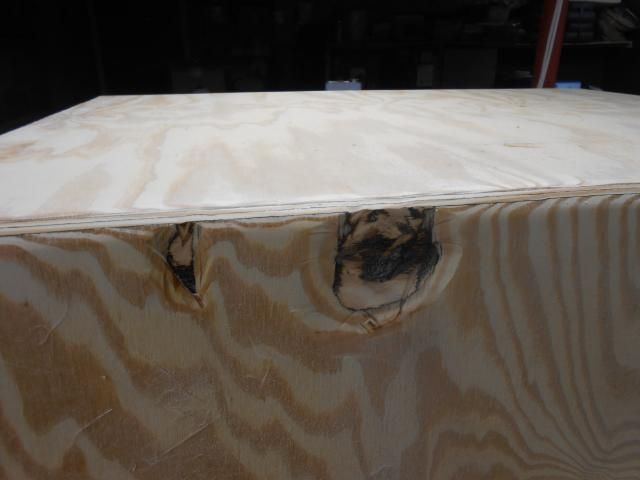

I cut out the carcass from 15/32 pine ply and layed it out and clamped it. wax paper under so it didn't stick to my table

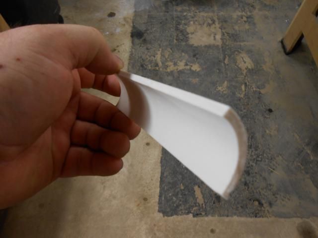

1.5" pvc pipe cut into quarters for my radius.

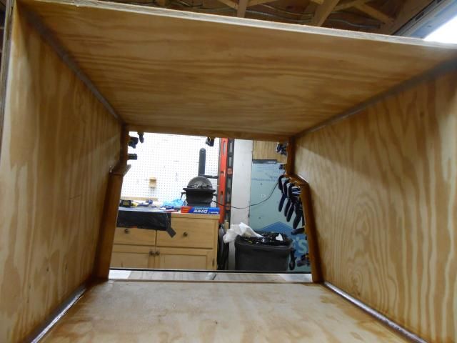

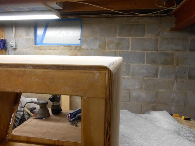

Made a little progress after work today. Installed the wood tabbing around the bottom that I will use to mount the console to the boat. Also got the hole for the hatch cut out. A few pics.
Pic from the top looking in.

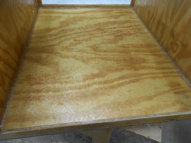

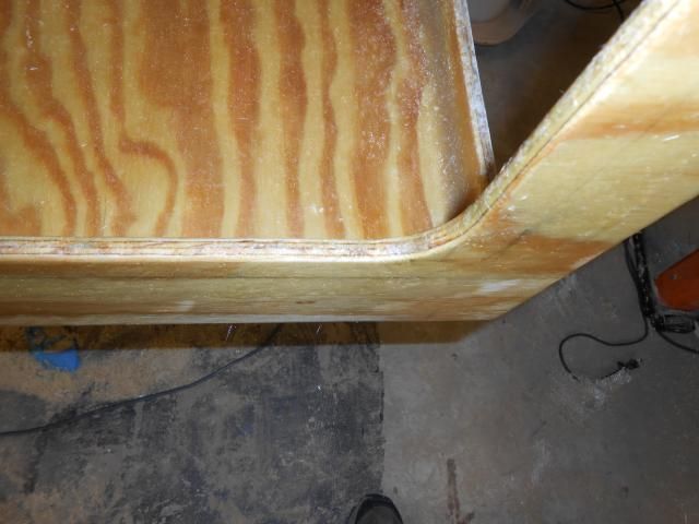

Started glassing the inside of the console on saturday night. Tabbed the corners, then layed a layer of csm on the one side of the console. Using poly and 3/4 ox csm. Man this mat sucks up the resin. Came out pretty well. Have a few voids on the tight corners on the mounting flange. Not sure if I should grind them out or if its ok. Just some small bubbles.

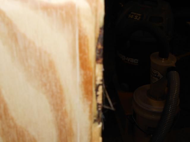

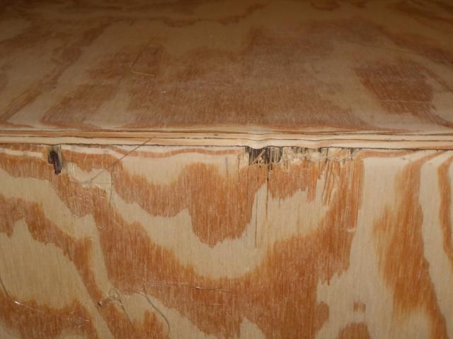

routed the outside corners with a 3/4 inch roundover bit. All went well except for the one side. Ran into some voids that blew out when I went over them with the router.
Turned out to be pretty large when I ground them out. Can I just fill them in with thickened Resin and then glass over them or do I have to do something different?

Fill all voids with Thickened resin. I'd use Glass bubbles with just a bit of cabosil so it will be easier to sand. CSM does NOT like a tight radius. Tearing the edges to make em "Hairy and then Dabbing the mat NOT Brushing it will make it lay down better but it's still a challenge. Waiting for that Magic moment when it starts to Kick Off and get sticky will also help hold it in place. You can also use masking tape to stretch it out and hold it in place.
