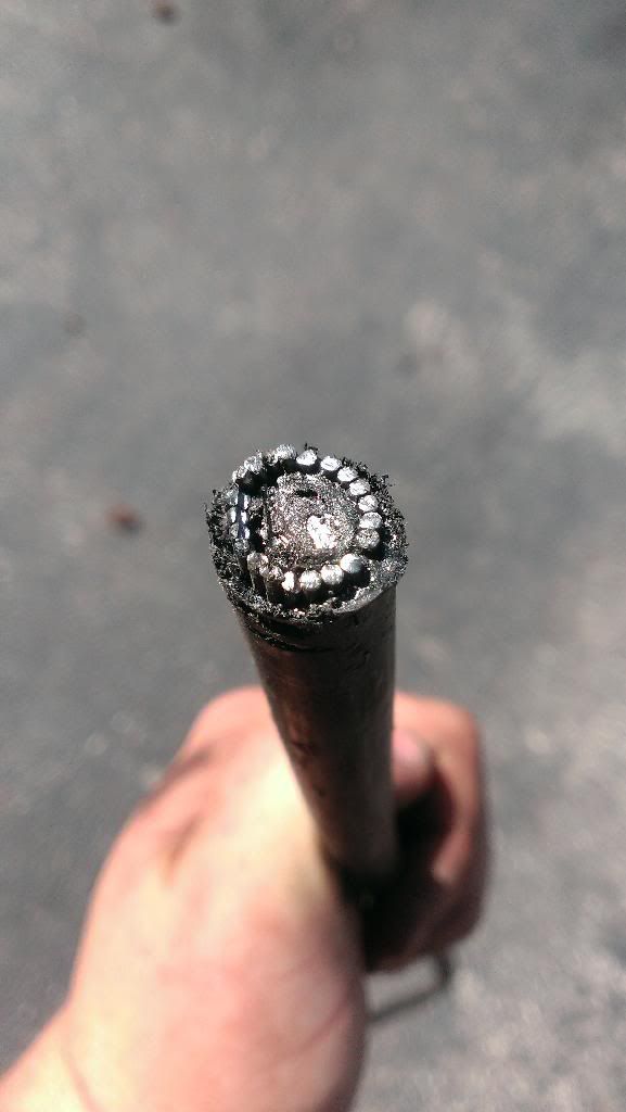

Got the pin out and was still stiff. Checked outdrive and she's loose as a goose. So I disconnected the helm and it's as free as a kite so that leaves me with the cable itself.... I've been working on this for a hour trying to get this alluminum tube unthreaded from the brass knuckle but this seems to be impossiable. Am I to undo those bolts holding that brass retainer in place ? Or am I missing something .
chrisp6108
Apr 11, 2014
15
Re: steering cable identification help?

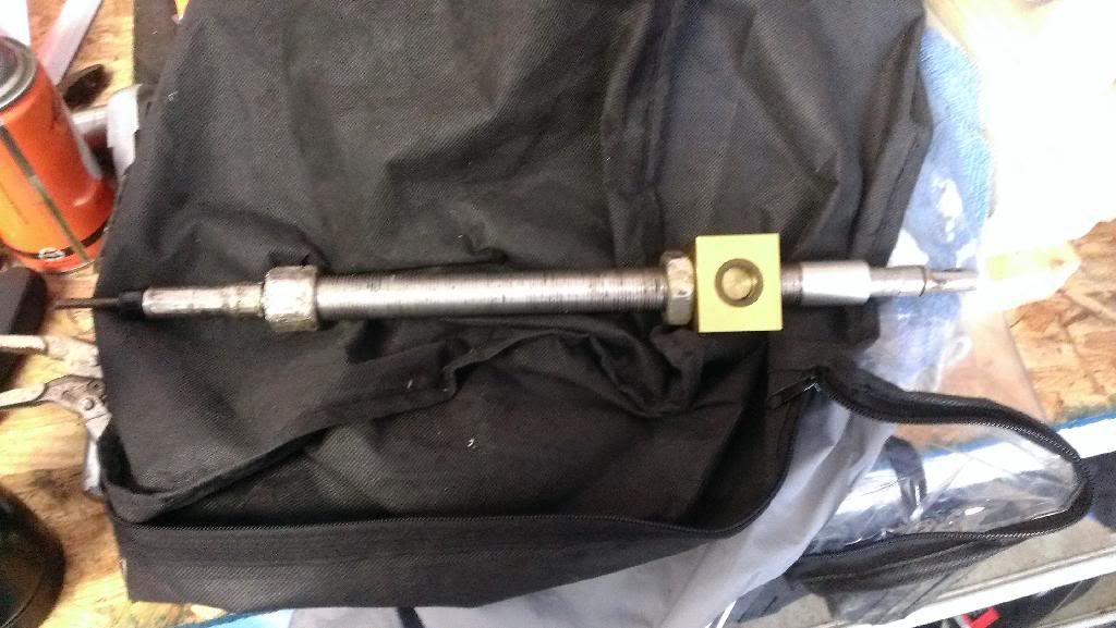

Cause when I turn the aluminum not at the end of the threaded part the whole plastic housing of the cable housing wants to spin with it I've tried gentle taps to break it free and tried penetrating fluid as well and nothing seems to want to free that from spinning the whole cable. Could I just use a sawjaw and cut the cable in half right near that aluminum nut ?
chrisp6108
Apr 11, 2014
15
Now hopefully this is my last issue. I cannot get the end nut off this so I can remove the brass knuckle .... I've tried heating it and water and breaking it free but no go. I'm affraid I'll damage the threads which in turn causes me not to get that brass off there without damaging it... Any suggestions at this point ??

anyone have any ideas on how i can get the brass off this without damaging them?
Bondo
Apr 17, 2002
71,489
Ayuh,.... If it's to corroded to get apart, ya gotta replace it,....
In the picture above, the nut on the left comes Off, 'n the cable has to be beatin' outa the aluminum tube, to the left,...
chrisp6108
Apr 11, 2014
15
ok thats what i thought but i tried everything i could think of, ill take it somewhere i know that can probably do it for me either way , ill win this battle LOL... but thats what i wanted to make sure it did in fact have to come apart before i went to town on trying to get it completely free. thank god this project is about done :)
