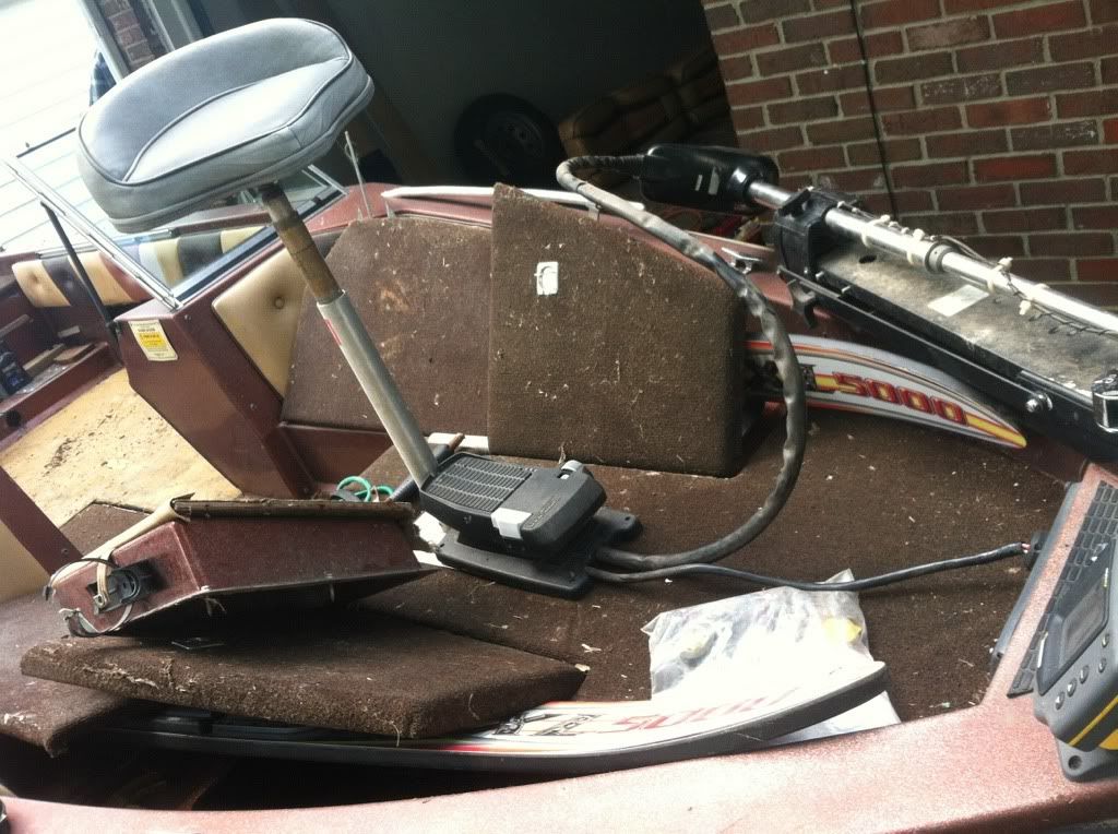

Well I got the boat and have spent two days scrubbing and digging into it. It was stored in a barn, uncovered, underneath a hayloft. It has quite a bit of mouse droppings and nests in it, an overall pungent odor really, lol. But it is a beaut in my opinion, I just have to polish her up a little.

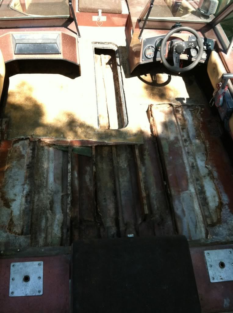

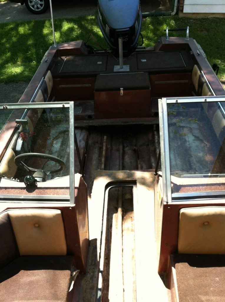

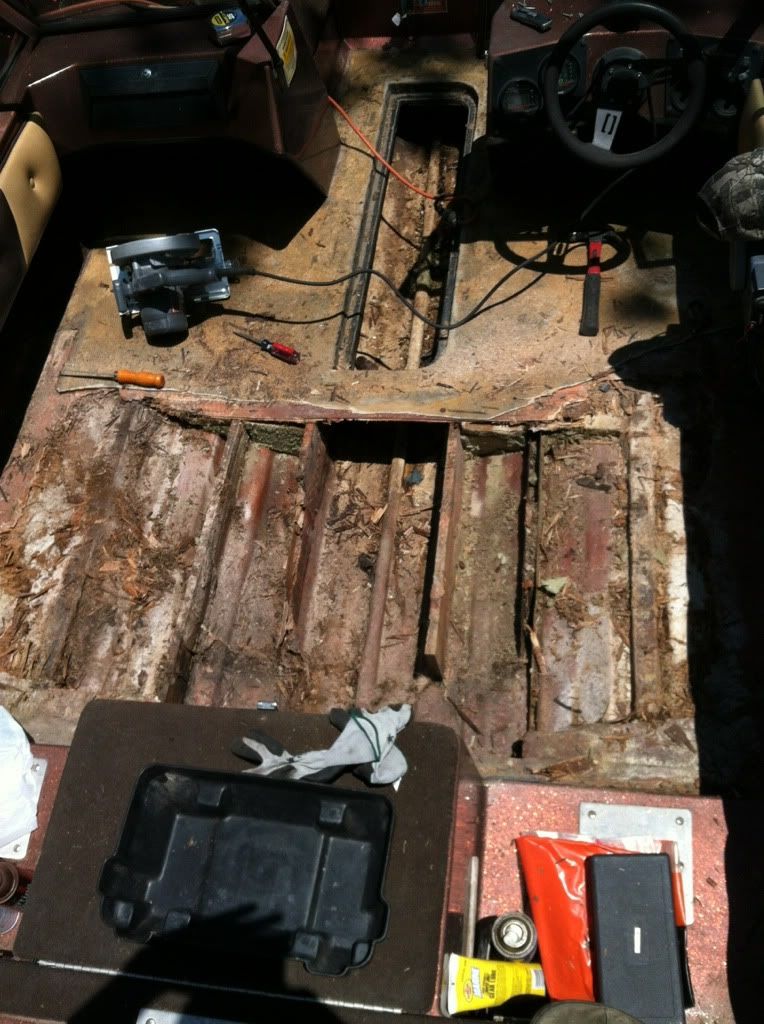

This is after carpet and first layers of glass were ripped out. Interior already stripped, a few seats are salvageable, some are not...
After digging down in and removed foam. Most foam was suprisingly dry except for the very bottom 1/2" of it. Most however was totally dry. The stringers that are glassed in place however are rotten in sections and need replaced. As shown in the next picture. What is the best way to do this? Should I try to dig them out of the old glass that held them in? Or cut that glass out somehow? I wasn't sure how to cut this extra glass out, being so close to the hull of the boat.

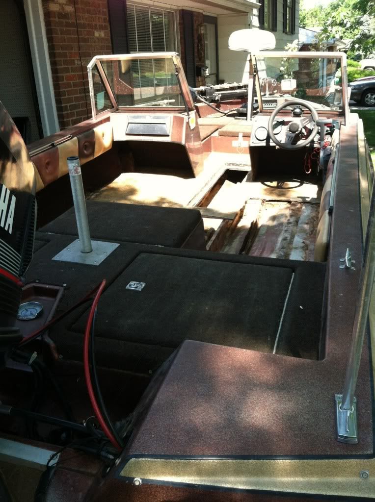

After a little cleaning:
And this is the motor idling after we finally got her fired up!

....The stringers that are glassed in place however are rotten in sections and need replaced. As shown in the next picture. What is the best way to do this? Should I try to dig them out of the old glass that held them in? Or cut that glass out somehow? I wasn't sure how to cut this extra glass out, being so close to the hull of the boat.
Get a grinder and put a diamond cut-off wheel on it. Cut out the old fiberglass as close to the hull as you safely can. Then put a sanding wheel on your grinder and take off the rest of the fiberglass from the old stringer.

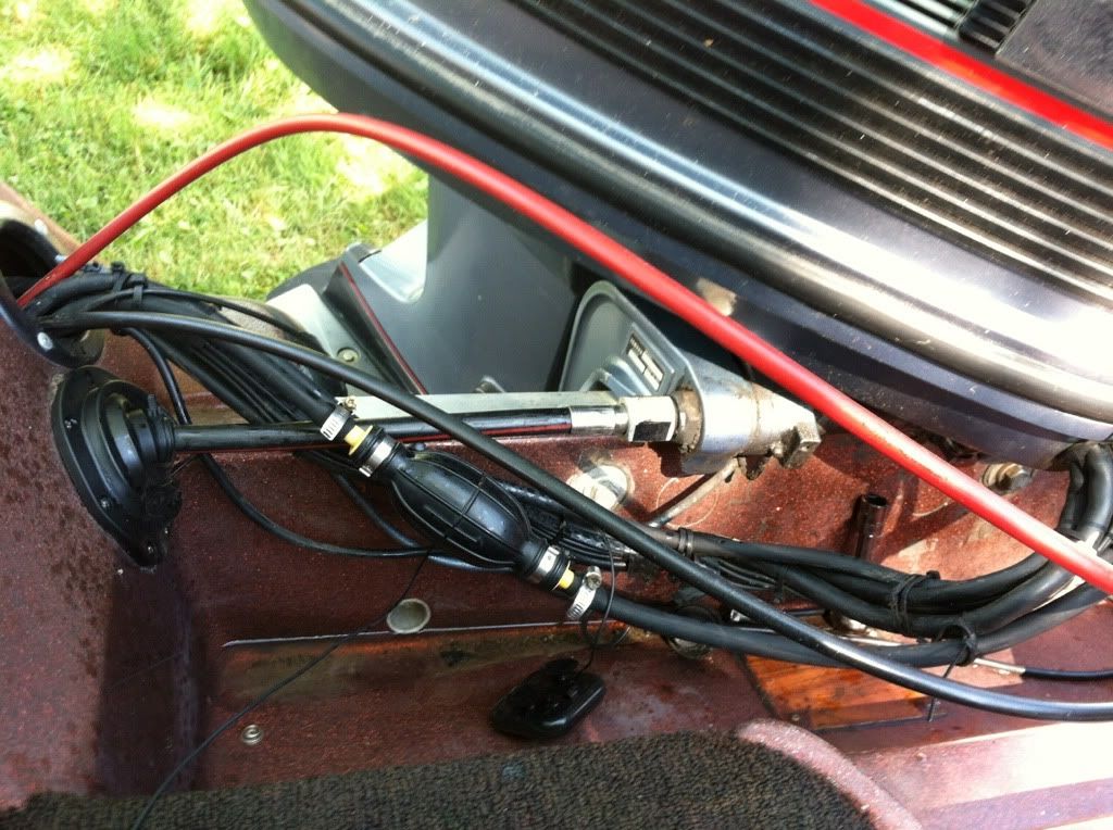

Working on the steering.
I unscrewed the nut that holds the steering cable to the back of the steering wheel, which if I understand it all correctly is a rotary system. The wheel will move freely, and "push" the cable now. But the cable is still attached somewhere inside of the steering wheel assembly? How do I access this?
Also, when I disconnected the same nut from the engine, I found that I could now turn the wheel, and the steering cable would "pull" out of the engine. See video here if it doesn't show up below (http://s277.photobucket.com/albums/kk65/Paintufast/Mobile Uploads/?action=view&current=IMG_0527.mp4
Does this mean that my steering cable is the actual problem, since the rod going through the motor does move?
And finally, how do I get this steering cable disconnected from both ends? I have unscrewed the large nut on each end, so the "hose" is free. But the internal cable remains attached somewhere...
Pictures of my setup
Oct 22, 2007
2,598
Re: Starting a Restore of 1986 Procraft 1750 F
It's difficult (or impossible) to diagnose some problems from a distance. You're going to have to figure out what's causing resistance in your steering system, whether it's the helm, cable, or engine itself. It's also possible you've freed up whatever was sticking.

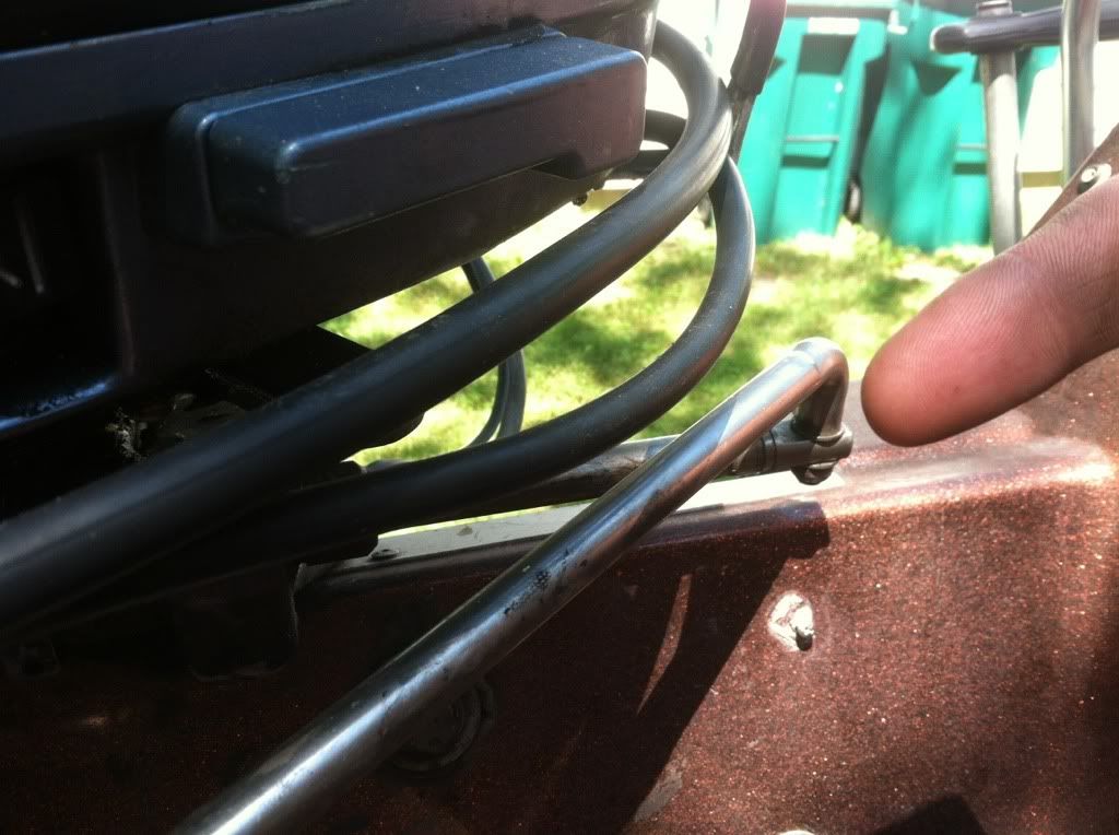

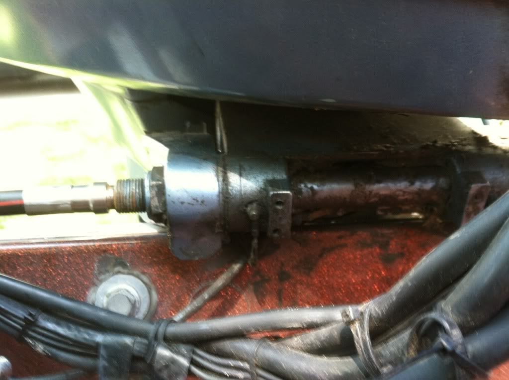

I have made some minor progress with the steering. I am certain that the problem is where the cable enters one side of the motor mount then comes out on the other. Everything upstream of where it enters the motor mount moves fine including the cable itself, so deductive reasoning says downstream is my problem. The solid metal tube on the end of my steering cable moves freely into and out of the motor mount, that is the last moving part.
I am at a loss after this? How can I free up or diagnose any further, the parts on the actual motor mount?
This is the part that is NOT moving, (it is currently disconnected form the steering arm of the motor which is why it seems to be hanging free). I tried tapping it with a hammer, and it does move in slightly, but I cannot push/pull it like all of the other steering parts.
I believe my problem is actually in here:
How/what do I take apart here to diagnose this further? I am at a loss here. I have been sifting through other peoples steering issues trying to get answers but it seems every problem is unique.
