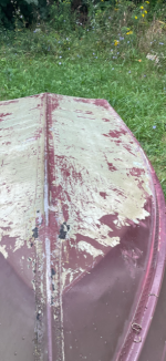

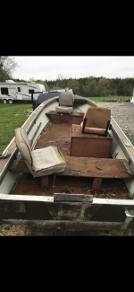

Ok here we go. Just started today.
Is there any sealant I can use on the inside seams and rivets? Or is that a waste of time?
Ready for a leak test.

Paging Dr. @BWR1953 to the drydock, STAT!
gluvit or coat-it for sealing rivets & seams
BWR did a great job on his Kingfisher and documentation posted in his rebuild topic is well populated w pix & descriptions

I did a leak test. 150 drops per minute out of the seams. Where the bottom meets the sides. Both sides.
Rebuck 500 rivets or just Seam seal?
We rebucked 300+ rivets, then leak checked again. It passed, so I then did the Gluvit. When finished, we had zero leaks and the hull has remained completely dry since then.

I’m going to seal the seams with coat it. Inside and out. No rebucking the rivets. Because the rivets aren’t leaking the seam is. Someone already put a sealer on the rivet heads and it would be difficult to remove. I know rebucking might stop the leaks but they aren’t leaking so they are probably tight. It must be a failure of the factory seam sealer.
If it leaks in the future I’ll have to fix it from the outside.
