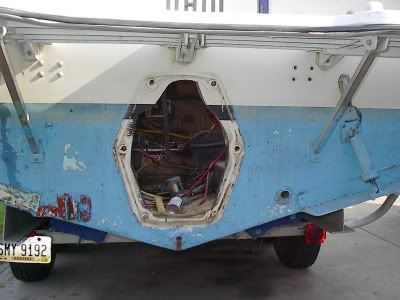

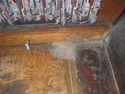

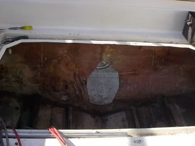

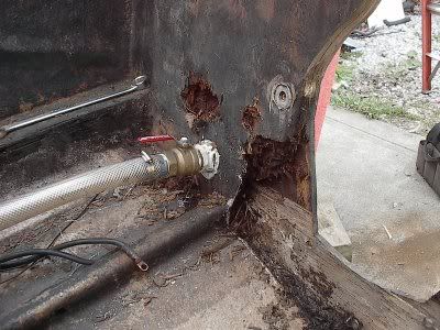

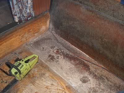

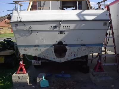

Finally got a bit of time to upload due to frost this moring. Saturday was a day of good progress. All the old stuff removed ready for prep work for new materials.<br /><br />Again, I wish to thank Evin300 for the tidbit on using a chainsaw for removal of old material. It works fast, not near the amount of fine dust, and not near the amount of the itchy scratchy thing going on. Below is the progress so far. Today's goal is get the new marine plywood cut out and prefit and maybe glued in.<br />
<br />After Outdrive removal<br />
<br />Area responsible for replacement<br />
<br />I hate it when this happens<br />
<br />Lots of wood to remove <br />
<br />Its outta there!<br />
<br />Lots to do yet<br />
<br />Now thinking "What did I get myself into"? I said that the first day I bought her as well.

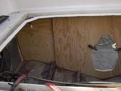

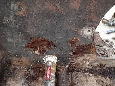

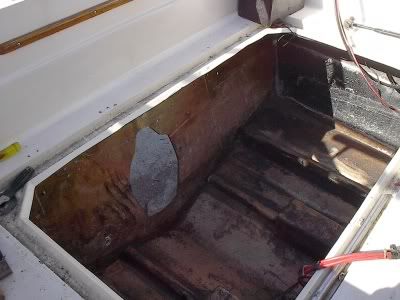

Got the plywood all cut out prior to the rain and cold. With the weather being crappy, thought I would start on the inside of the cabin. At least I'm not getting rained on.<br /><br />I had problems with the wet foam syndrome, so as you can see in the pic, I got more work cut out for me. Sure wished I had done that area when I did the stringers 5 years ago.<br /><br />Pics of the new plywood<br />
<br />
<br /><br />Can ya guess what my favorite tool is?<br />

Good work SS. Nothing like a clean slate to start the repairs from.<br /><br />Do you just use the tip of the chain bar to do your cutting?
SS MAYFLOAT
May 17, 2001
6,372
Re: SS Mayfloats Transom Replacement Project status

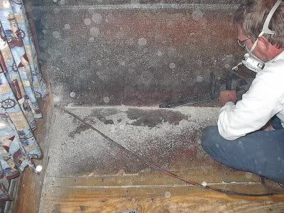

Yes sir, It takes a bit of practice, I saw at just above an idle just to engage the clutch. The main thing about using the chainsaw is that it takes big chunks out vs the itchy powder stuff. If you do run at a fast rpm, it tends to produce a finer powder. The tip of the saw is good for roughing up the surface as well. The chain will beat the existing surface exposing fresh fibers. This makes for good adhesion. All the areas that I prepped with the saw method has yet to delaminate. <br /><br />I've got to give evin300 the credit for giving me the tip on using a chainsaw back in 2001. The best tip I have used to save time.<br /><br />Here is a few pics of removing the port side floatation chamber. I was surprised that it didn't have the saturation of the starboard. Some rot in a few areas, but nothing that can't be fixed easy.<br /><br />Going to install 4"pvc in the floatation chambers to use as my fresh water tanks. I'll try to keep up with all the crazy stuff going on with it.<br />
<br />First cut and out of gas<br />
<br /> Doin me thang<br />
<br />Easy mess to clean up

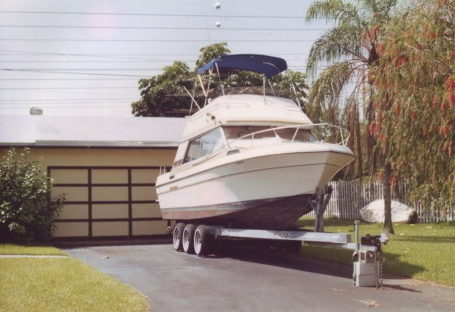

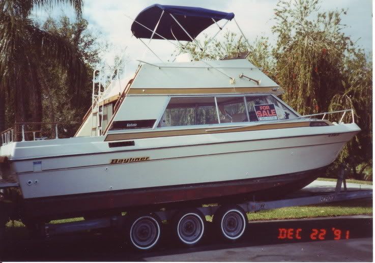

I grabbed a couple of shots of my 1977. Is this like yours?<br /><br />
<br /><br />
SS MAYFLOAT
May 17, 2001
6,372
Yep, thats her, almost down the the triaxle trailer! Mine lost the Bayliner sticker just shortly after my purchase. Hmmmm don't know why or how, it just happened.<br /><br />My water line is in the same place as yours was. I was thinking that it was sitting too low all the time, but guess that is where it is surpose to be.<br /><br />This whole week has put me behind schedule. Going on 9 days of rain. Keeps it up, I'll have to find a big garage. Thanks for sharing your pics SoLittle.
