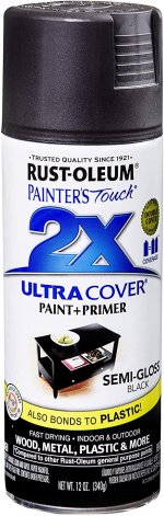

I have a Mercury 100hp outboard that I will be repainting in the spring, everything except the prop and transom mount. The plan is to strip all the original graphics off, sand, repaint and put new oem graphics back on it. I have had good results using Rustoleum2X on other projects and had planned on using it on the outboard but want to ask here to see if there's a reason I shouldn't use it.

you will get better results if you use straight rustoleum, mix in some hardener and spray with a real spray gun that way you get a hardened finish with out the rattle can zebra stripes

Whatever method you decide on, make sure you are applying a catalyst type paint IF you want it to stay on for any length of time. PPG makes awesome paint and worth the cost. And when properly applied it is resistance to oil, gas and fuels. But rattle cans don't offer the quality of catalyst paint unless you buy the special two part type rattle can setups. Most rattle can paint will dissolve when fuels touches it. They are what they are, and that is an easy to apply paint, but absolutely NOT fuel proof!

I did not think about regular spray paint not being fuel resistant, but with my luck at some point there would be some fuel spillage or a leak on a 30 year old motor. Thanks for the input. I don't have access to a traditional spray gun and compressor so maybe I can compromise and get a catalyst type of paint in a two part spray can.
