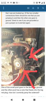

One of the small post goes to the block for ground and the other post has a wire that feeds into the big red plug. How do I correctly jump the solenoid?
Jump the main incoming hot to the one coming from the harness. That powers the solenoid. If the soloniod does not click then its bad. Check that and report.

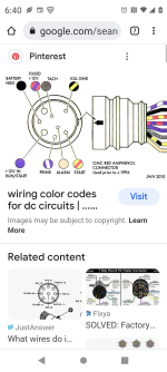

Your starter is still struggling and your partner was playing with the connection. If you don't use all good stuff your going to ruin your starter. Also, don't get ahead of yourself, fix things before you run it.....like the water pump impeller and don't run it without water.
Here is the red plug wire diagram. Run a wire from where it's says kill through a switch and to a motor ground.
Looks like she has some life.
