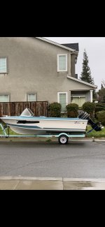

Hello , new to the forum . Bought a 1967 Larson from the family of an owner that had passed away . The family knows nothing about the boat or any work that was in progress . A new wire harness was installed from the motor to the front and this purple wire runs to the front and has no connector in the front . The boat has all new gauges with nothing connected . Question ? What could this purple wire be run for ? The engine is I believe a Mercury 1963 650E. Serial # 1598418. . Engine starts on second turn .
