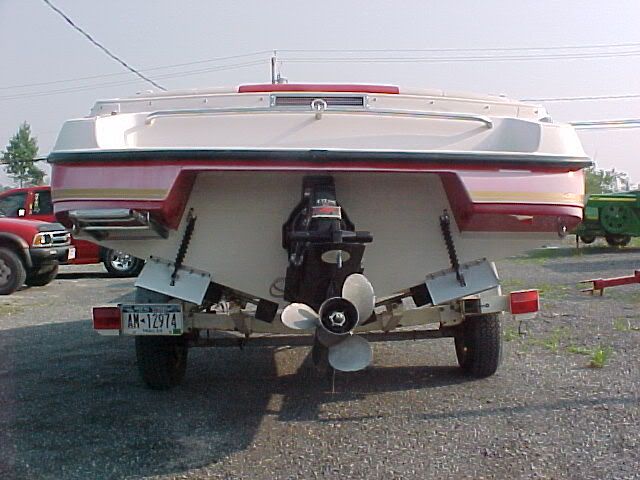

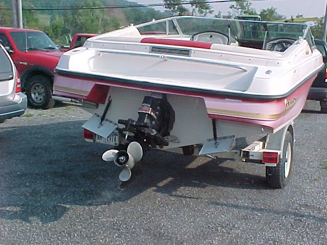

Ok, finally got the boat in the water last nite<br />with the Smart Tabs on. In conversation with John, he figured on the 60 lb tabs, but when I ordered another person recommended the 80's.. so, I started with the bottom setting about 1/4 away from the least most pressure setting, and I think I will try it all the way, and see how it goes. I felt last nite like I lost maybe 2 mph, but acceleration was so much better, no bow rise hardly at all.. the boat did much better in reverse around the dock, and the slow speed wander is gone! Just as everybody else has mentioned!<br />It felt much more stable at high speed corners, almost made the boat feel flat on the water. Tonight will be another test,, with about 5 more people and possibly trying to pull the wakeboarder. <br />My planing speed was as low as about 13, incredible to just cruise at a low speed. I thought planing time was about 3 seconds,, just seemed like a straight pull and on plane so quickly. I did notice a bit more spray from the back of the boat, and maybe that is due to having too much pressure still. I am still not so sure that I won't be dropping to the 60's. <br />Here's a pic of the tabs on my contoured stern. <br />Installation was a breeze as everybody says.<br /><br />

dutch;<br /><br />First, if you have lost speed then the pressure is too high. Second, it looks as though you left the white film on the plates, That is a protective film for shipping and handling purposes. It covers the polished finish. You can remove it.<br /><br />The extra spray in the back is most likely do to the extra presure. When you reduce the presure the spray should go away.

Thanks John,<br />Sorry about the pics, I can't see them,, not sure how you can!<br /><br />How much pressure are we talking along the length of that adjustment on the bottom grove?

Your pictures were there a minute ago, but not now. The more and more I see and read about these tabs, the more I want them. My wife gets tired of me driveing faster so I can stay on plane, she doesn't like the bouncing around. The more I see, I think these may be the perfect solution.

ok, enough of yahoo crap,,<br />put them on photobucket,,, <br />we'll see if that makes a difference..<br /><br />As far as my tab setup,, the boat is a Crownline 182,, just over 18', with a 4.3LX 4bbl mercruiser... turning a 21p (today slightly dingedup) aluminum prop. Once I get the tabs adjusted properly, I am contemplating a prop change, possibly to SS, and from there maybe even to 23P, I'm turning just about 5,000 rpm's now with the aluminum.. and realize that's a tad high. And, with the new acceleration characteristics with the tabs, I may not lose any hole shot, and could pick up a few mph... to put me over the 50 MPH mark!

Question for John...<br /><br />Looks like dutch installed the top left ball stud backwards (according to the instructions). I did this also when I installed mine. It seems to work fine. Do you see any problems?

BRG, <br />I did that to try to keep the tabs as far outside as possible, and put the upper brackets so the screws were closer to that contour, and so that the top of the actuator could snap on and off with enough room and not have to worry about interfering with that contoured area. <br />I don't see any reason it would hurt, and felt the instructions were a bit vague about it.. almost like it's a non issue.<br /><br />where do you boat? ever get up to Caz lake?

Dutch and BRG;<br />There is no problem with changing the Ball Stud position. <br /><br />S1jor;<br /><br />Regarding the wake size: How far the stern / boat sets in the water (draft) is what determines the wake size. The trim tabs will normaly reduce the wake at any given speed. For example if your are running at 20mph (your minimum plane speed)the trim tabs will allow the boat to be up on top more and reduce the wake. Two things can be done, one is to trim the bow up with the tilt trim on the outdrive, and/or slow the boat down. Keep in mind that the boat will run at about 15 mph on plane with the tabs. The slower speed will allow the boat to draft more. The third option would be to bring the tabs up so that they were not working. This would however create a high bow rise. You could also move more people to the back of the boat, or add bladders of water.<br /><br />I wish I could tell you that trim tabs do not affect the wake, but they do. However other things can be done to bring at least some of the wake back.

Yea, I haven't had any problems with the ball stud installed that way.<br /><br />Nope, never been to Casenovia lake. I mostly stay on Skaneateles, Cayuga and Owasco Lakes although this weekend I'm taking my boat up to Alexandria Bay.
