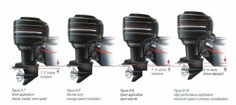

The density of water is ~784 times more dense than air. Therefore any excess of the lower unit below the waterline produces a lot of drag. It also introduces the increased hazard of the lower unit hitting something below the water surface damaging the lower unit or causing major injury or death to boaters at high speeds. I implore everyone to not listen to the BS put out by Sea Rider.

A) the higher the motor the more efficient it is. This is due to less drag in water
B) less prop blades in water(a prop is most efficient with 1 to 1-1/2 blades submerged).
C) rounded part of lower unit housing actually provides stern lift
D) all the above can lead to a pitch and RPM increase which = more MPH
E) This will apply to 75% of ALL boats made less dingys and ducks
