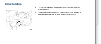

Hey Lou,
In the Volvo Penta manual it talks about cranking the engine after draining to get water out of the impeller housing. Is that necessary if I am doing the above? Cranking without water makes me nervous.
