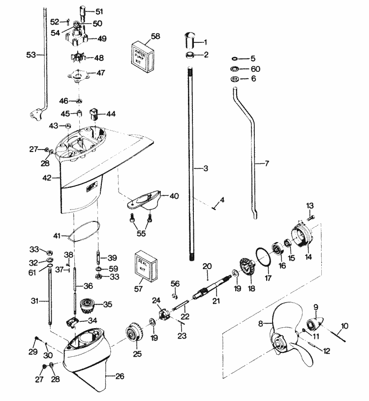

Yeah it looks like the the seal and retainer that goes on the spline. Heres what it looks like on my Force 50 HP part #1 & #2

it's should be on the shaft at top. But it's not a deal breaker if you want to wait till a more convenient time this summer. As for the prop that is normal as you usually have to put the drive in N to line up the shift pin with the shift rod. if you put it in F and spin the prop to the right it should lock. then try R and spin left it should lock. Then put in N again and it should be free.

Put the seal back on right now because for one it keeps water out of the splines where the power head and drive shaft meet preventing the two from rusting together. If you forget to put it on right away you will forget about it and find out later the hard way that you didn't put it back on. JMO
Apr 13, 2016
6
Yes, I agree. I am going to take it back off and put the seal back on. Just have to figure out what order they go on. It is the rubber boot and the metal ring.
SkiDad
Jul 18, 2010
1,518
the metal ring slides down 1st - the cup/grove is facing up - the flat side of the rubber piece slides down into the ring. the tapered end faces up
