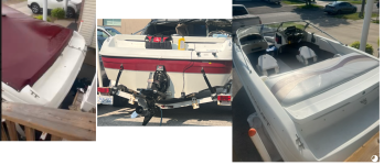

This is the current setup. it just occured to me that i did not mention - i do have a trolling motor. 2025 terrova 80lb 60"

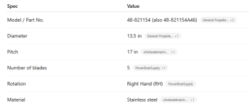

I like my current 5 blade. It actually goes right to 4700RPM at WOT. its perfect. i do lose about 8mph on it, but i get on plane in ~3-4 seconds. Below are the specs in case you're wondering. This specific high five is 100% perfect for a 2002 starcraft 1810 with 4.3L 1761672245927.png

I like my current 5 blade. It actually goes right to 4700RPM at WOT. its perfect. i do lose about 8mph on it, but i get on plane in ~3-4 seconds. Below are the specs in case you're wondering. This specific high five is 100% perfect for a 2002 starcraft 1810 with 4.3L View attachment 412706
you are already on the lower side of pitch with a 17".
