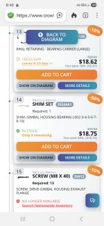

Old bearing must have spun in the recess and enlarged the hole. The new bearing is now slightly loose in the gimbal plate hole.
Can I use shims to hold the outer race tight ?
I see shim sets for sale at Crowley for this year gimbal plate. Are these used for this?

I think I may have understated "slightly loose " the housing has maybe 0.08 - 0.12
Gap all around.
I thought of JB weld and use old driveshaft to center it while while curing

save yourself the destruction and buy a new bearing with the ring already for install instead of trying to get by with just a bearing and not its carrier. you can use a late style , remove the snap ring and everything else in there and install the new perma-lube bearing and install with the correct tool, No shimming necessary
If memory serves me, the ring was a teflon one you shimmed with the brass strips

A few years ago I installed this bearing shimmed with a few strips of thin aluminum. (Perma lube type; retainer, race and bearing all in one)
I seem to remember that the separate nylon retainer and bearing were not available then.
When looking for other parts I saw these shim kits. Thought I might try it while engine was out. (rear block core plug)
This is a rarely used hobby boat and
It'll be a while but I'll let you know how it works

Took the drive off for the winter.
The bearing seems to be snug in the gimbal plate.
It has the strips of aluminum printing plate for shims.
