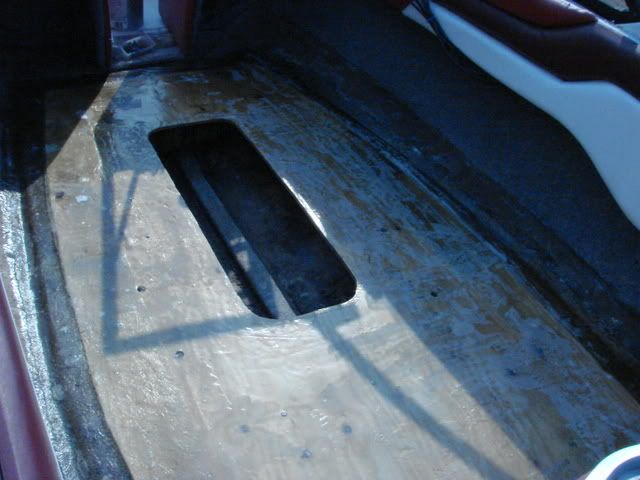

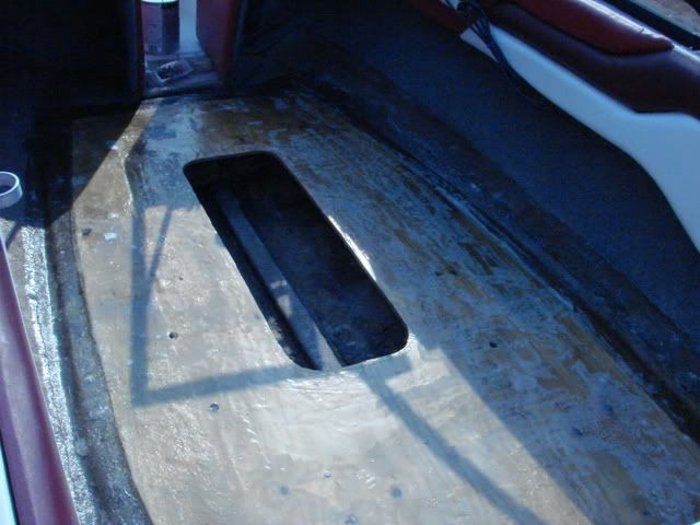

Well I have almost finished the project and wanted to include some of the work photos
here is the new deck layed in, i took it back out after originally laying it in, to give the underside one more coat of resin, top side got a coat of resin, then was Glassed up to 10" of the sides to give me enought room to tie in the mat of glass once layed in place
I will be laying in the seats next and buy a rug for the high traffic area in the aft section of the deck.
TELL ME WHAT YOU THINK!!!!!!!!!
I glassed pretty far up the sides to allow for a stronger bond and for a water tight seal
