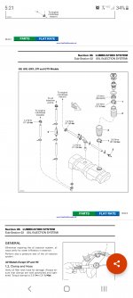

Another thing I saw was that there is still a large hose hooked up to the engine below the carb from the oil reservoir and a smaller hose is capped off. I looked in the manual for the larger hose but it just says it goes to the crankcase. I didn't see any oil in the crankshaft area though. In the picture of the oil system the hose I'm referring to is on the far left.

Not sure about the hose, but how do the crankshaft bearings feel and look?
