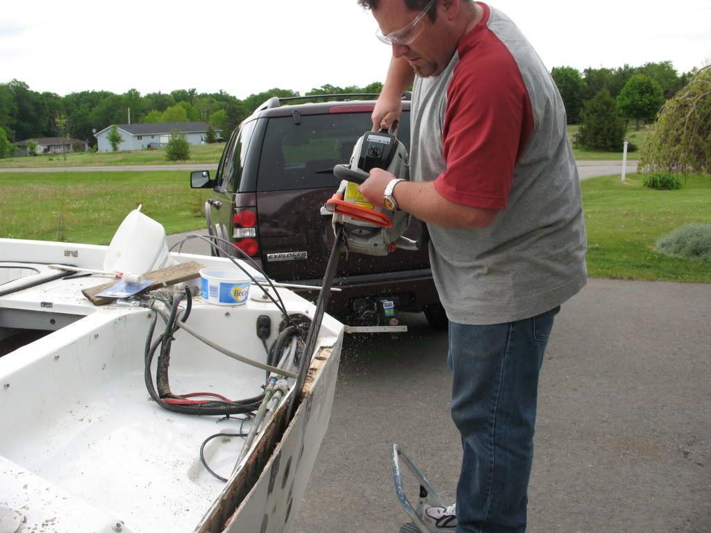

I used a spade bit and a small 18" electric chain saw to get most of the wood out. Then I graduated to a 24" for the last couple of inches of wood. I bought some flat steel stock about 1/8" thick and 3/4" wide and ground the end into chisels and scraped the glass of any wood. I also used a forstner drill bit with the tip ground off to get the bottom clean without excessive chain saw use. The Seacast folks are super. The worst part was glassing the inner parts of the transom where the foam met the old wood, such as the towers on the splashwell. You pay more for this stuff but it is proven and the customer support is just wonderful.
