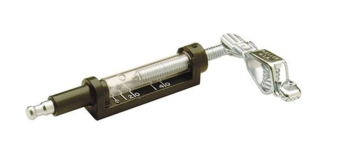

I did use spark plug tester and i see the it lights up also i put the spark plug on yhe bolt to see the if it spark it does
post a picture of the spark plug tester. because if it isnt an adjustable gap tester, you didnt test anything. does the spark look bright blue or weak orange? did it jump a 3/8" gap?
