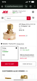

A few years back I posted a few flushing nozzles that I made for going in the drain plugs
Basically this adapter and a section of 1/4" OD nylon tube
The natural curve of the tube helps to "aim" the flushing stream
