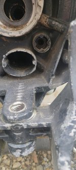

Just to clarify tho. The small hole off to the right is the water inlet right ?
No that hole is the shift cable. Looks like your gimbal ring and bellhosuing is off? There is a 5/8 hose that connects to bellhousing clamps on a right angle fitting at top above gimbal bearing can put a hose on there or go inside engine compartment and find hose coming up from drive to the heat exchanger. Can stab the garden hose in there.
read up on the 485, they have an iron head and aluminum block tend to blow head gaskets with minor overheats… so make sure you put a new impeller in outdrive.
there are some guys on here who run the 3.7 who can walk you through the nuances of maintaining them

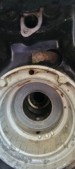

Looks like we'll need an whole overview photo of what you're working with there.
scarinu10
Jun 18, 2020
28
Ahh the rusted pipe right above the gimbal race here?
Also while I'm asking... again just trying to get reacquainted.... what is the hole at the top there that takes Two bolts?
