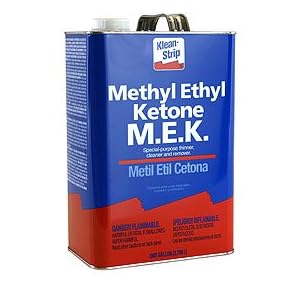

However, I would recommend you remove the carpet. I believe others on here have had success with MEK
Then look into a coating like Durabak, Kiwi Grip, Herculiner, etc etc.
