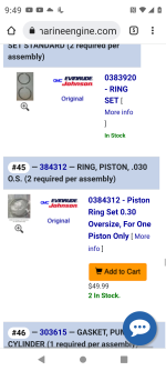

4hp on a 14 ft boat? Trolling I hope.
Rings are available as well as other stuff
Honorary Supreme Mariner
40,028
Does not look like rings are available at the dealer ?----E-Bay likely has a vendor with some on the shelf.
