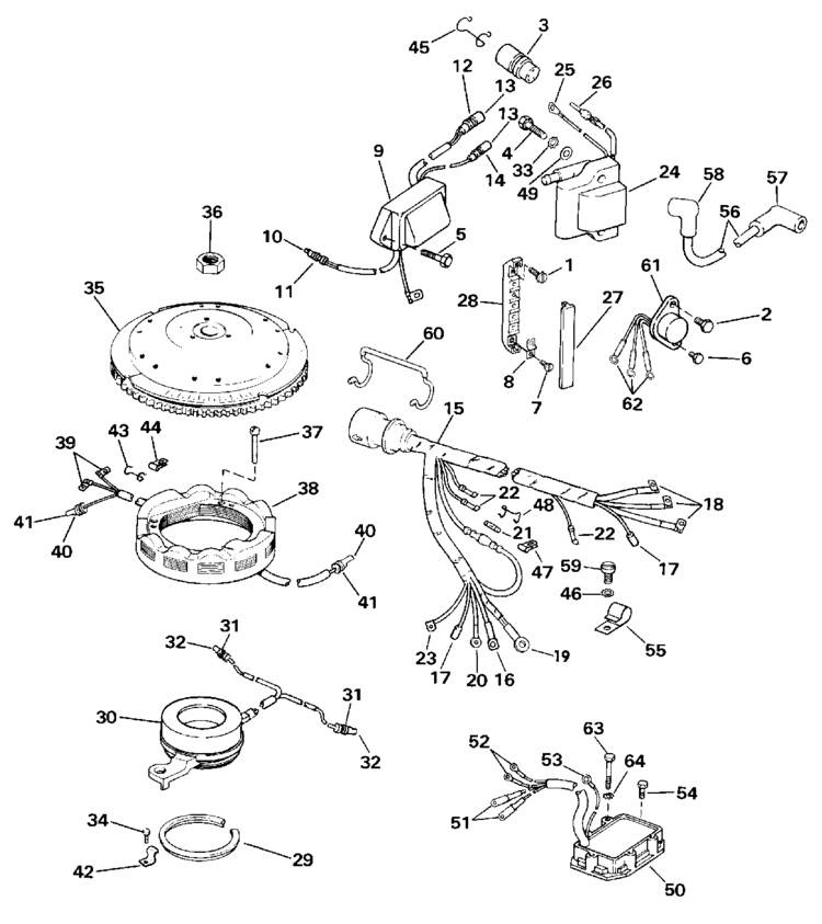

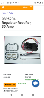

I would like to test and possibly replace the rectifier. This seems to be the correct part, but I'm having trouble figuring out where that part actually is on the motor.
I can see the rectifier on this diagram, but I just don't really understand where it is in relation to the overall motor...

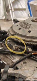

@racerone - is it this thing?!?
Can I test it without taking off the flywheel?

Crosbyman
Nov 5, 2006
6,271
if it works you should see voltage go up couple volts on the battery posts after starting the engine.
without checking the AC voltage (2 yellows) to confirm the AC source is ok changing the rectifier/regulator won't help.
Jan 17, 2019
963
i do the diode test on an unknown motor anyway. super east yellows to ground both ways, then red to yellows both ways. high reading one way, none the other.
