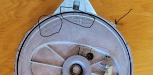

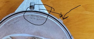

to work good some of the older engines have markings on the recoil base which must line up... I do not know if it is the same for a 55 recoil but check for bars and an arrow asin this picture.
when the rope is rewound the arrow must line up with the bars
I'll check it out. Thanks
