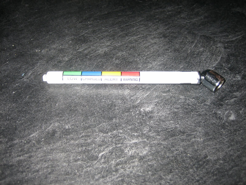

I also picked up one of these little ditties at Pep Boys. I know it's not precise, but hell...this could all leak out in 2 days and be for nothing anyway, right?

In my case the 200 lbs was really 100 lbs and the one can got it up to 150 lbs. The second can I bought suuuure would have been nice to have.
In the end, the truck produced relatively cold temperatures. 50s, maybe. 60s? I dunno. Colder than the 90s and 100s the windows have been producing lately.
