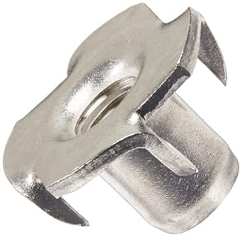

In the factory pic in your sig pic it looks like the back seat base is round. I'm trying to imagine the bar of AL working in that instance? On my SN I used SS T nuts with the teeth and used machine screws to secure the seat bases. If you can reach under and push the nut into the hole and thread the screw in it will tighten down on it's own and stay in place if ever taken apart again. You can also use blue locktite in the threads if you're worried about them backing out. On the AL part you can use the T nut without the teeth and butter the flange with 5200 so it stays there..
Kind of hard to push those T-nuts into the aluminum under the plywood back deck !
This would be great for the other seat bases except for
  • The hole for the seat base "cup" is too small for my fat hand
  • The area under the floor is of course full of foam. Much would have to be chopped out to reach far enough over to push the T-nut in
