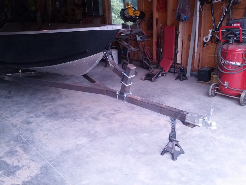

Hello all! I am in the process of finishing up a nice boat trailer I built from scratch using tube steel. For the main structure I used 3x2x.125 rectangle tube, and for the tongue I used 3x3x.188. A 16' Polar Kraft Dakota deep v will sit on it. It is a basic aluminum boat, pretty light actually and the trailer is built pretty heavy duty for the wet weight of the boat. I designed and built the trailer so that all of the tubing with the exception of the tongue is welded airtight. For running wires I was going to attach them to the inside of the tube and where it crosses each cross member or has to cross the trailer the tube has been sleeved and seal welded both sides to make a hole that wont allow moisture inside. This boat will NEVER see salt water nor will the trailer. I built it to last but again I don't plan on owning it forever because I know down the road living in Michigan I will want a bigger "Big Water" boat. My question is what should be done about the inside of the tube steel? I received a quote for 400 for hot dip galvanizing the trailer, but it will need to be hauled 3 hrs one way and back and with work it sucks trying to make time and I already purchased a good quality epoxy primer and black paint to paint it. Hot dipping it would require vents drilled in it which wouldn't be a big deal because it will be galvanized. My second option was to weld in a 3/8" or 1/2" NPT coupling into the bottom of each sealed section and one at the top and add a thick viscosity oil into the inside and seal it back up with a plug in a unseen area. I don't see how painting the inside of tube steel will be possible, especially being all new steel and coming with its millscale and oil finish on it. I work as a industrial pipefitter and haven't seen the inside of any tube structure painted, but nothing is submerged in water either. Is it something to worry about, or just run it as is? Any suggestions would be appreciated! Thank-you!

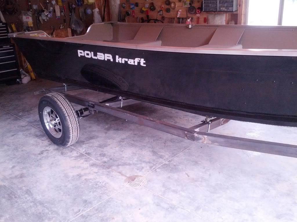

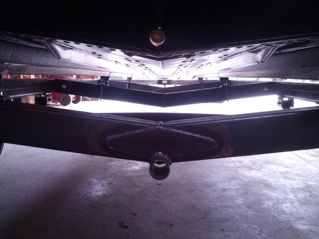

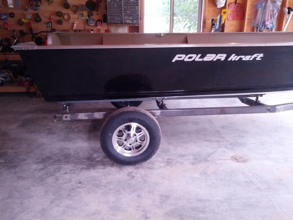

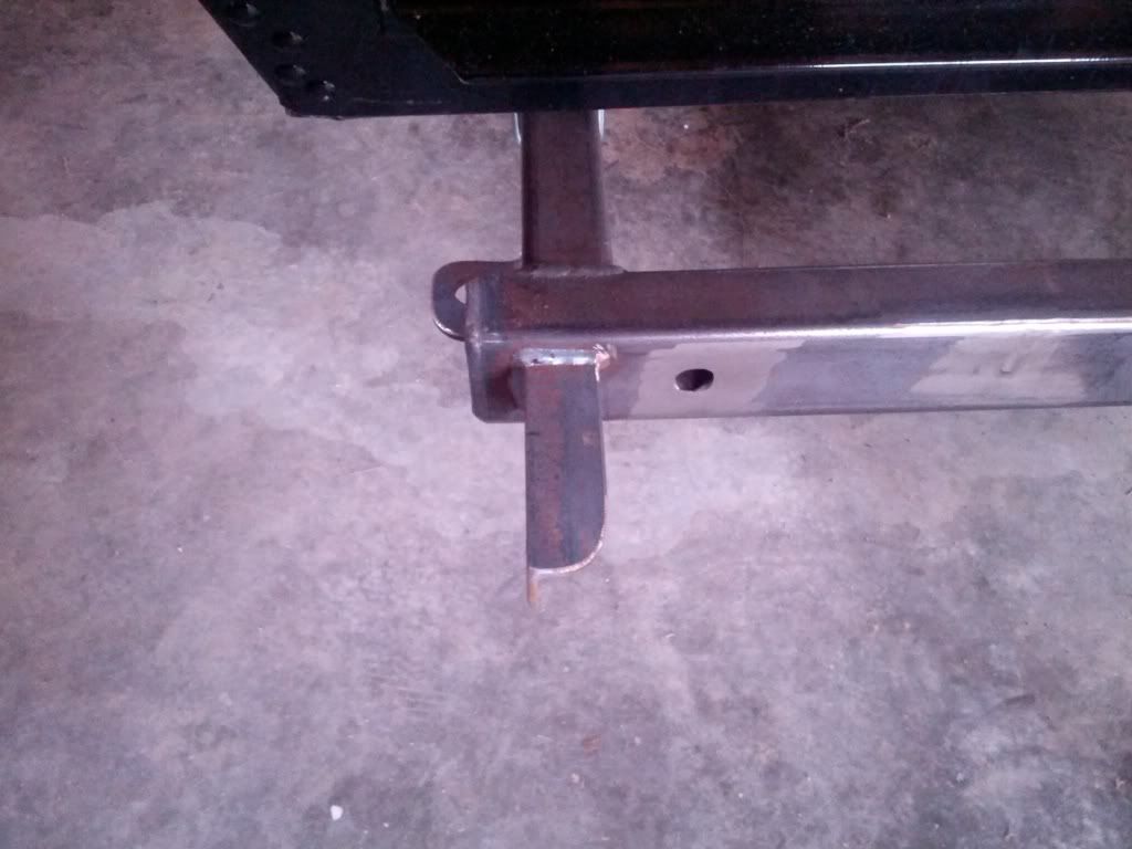

Thank-you for all the replies and suggestions! I will get some pics on here real shorty showing the trailer, and I will give a little disclaimer that it is pretty overkill for the boat that is on it...but I guess I'd rather build it once than multiple times. The wiring wont actually go inside the tube, I'd like to find a way to mount some either flexible corrugated conduit like you see under the hood on your wiring harness or go with galvanized emt conduit on the inside of the frame rails where you wouldn't see it, if I were to enclose it and give it a oil bath they would never contact the oil. any spots were I need to jump through the frame have been drilled with a hole-saw through both sides, then a piece of e.r.w. tube was put in and welded on both sides then ground smooth to make a sealed penetration through the main tube. Judging by all the advice I may just do the drain holes like everyone said. I wish I would of realized this before taking the time of sealing it all up...but hey you win some and you lose some....:laugh: The pics will be up in just a few minutes, I used ultimate bunk boards for the bunk boards and I have yet to put the fenders on and build the front keel/bow roller bracket. Once again thank-you for all the advice, I really appreciate it!

I wish I shared your welding skills. Nice looking trailer.

That is a sweet looking well built trailer alright. Great job!
