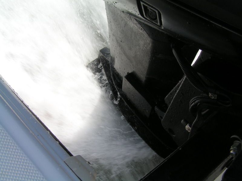

The diagram above is agood starting point but you will likely need to go up a little higher than that. If the engine is mounted directly to the transom and there is no notch (running surface of hull runs all the way back to the transom) then you will need to mount he engine with the anti-ventilation plate (sometimes called a cavitation plate) a little above the running surface. The "plate" should be skimming the water surface when normally trimmed and running at a typical cruise speed. having someone take a pic over the transom like the one below will help determine your setup. Propeller type can greatly effect how high you can go along with water pressure and boat handling.
