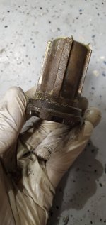

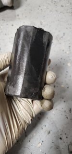

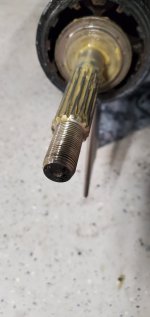

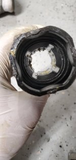

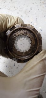

I took it apart. I have the flo-torq hub and it looks fine; no cracks or visible wear. I am truly perplexed.
Boating.Bubba
Jul 9, 2021
11
Here are some pictures.

Reading your first thread I would think about disassembly of the lower. There is something wrong it the shift area.
Update. Seems that the clutch engages when the lower unit is laid down.
