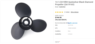

How about this 3 blade? The cost of the merc/quicksilver seems pretty similar to Michigan Wheel and Solas. From what I've read the Alpha 1 can fit a 14 1/2" diameter. Thoughts on the Flo Torq II hub? For the extra $60 kit, seems like cheap insurance against driveshaft damage from strikes along with improved shifting and vibration (maybe this is not all that noticeable).
alldodge
Mar 8, 2009
44,645
@gsbarry if you look long enough no matter what anyone tells you there is somewhere else which will provide a different set of facts or opinion. Your posting above is true but also need to know where it was taken from. The question of where is need to determine how it was presented.
Saying a 4B provides better hole shot and better handling at slow speeds "IF" (note the if) your talking about a light boat with sufficient power. Your boat as 1 of the 2 items mentioned. It is a light boat but does not have sufficient power.
It is correct a 4B has more surface area and therefore has less slip. Slip is good and bad. Good so every turn of the prop bits in hard and moves the boat forward (with sufficient power) more efficiently. Bad because a motor needs to get the rpm's spun up fast to get into the torque band. So 4B does not allow the rpm's to come up fast.
The 3B has less area and has more slip. Good is with more slip the prop spins faster sooner and gets the motor into the torque band. Bad is more slip
So the rule of thumb due to differences in surface area, a 4B pitch equals a 3B with 2 inches of pitch added.
